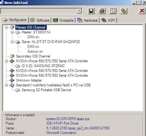

Kód: Vybrat vše
Nero InfoTool 4.03
Interface Information
--------- Adapter 1 ---------
Description           : Primary IDE Channel
Driver
Description           : system32\DRIVERS\atapi.sys
Company               : Microsoft Corporation
Version               : 5.1.2600.2180 (xpsp_sp2_rtm.040803-2158)
Description           : IDE/ATAPI Port Driver
Attached Devices
Description           : Master: ST380011A
Type                  : Disk Drive
DMA                   : On
Description           : Slave: HL-DT-ST DVD-RAM GH22NP20
Type                  : CD-Rom Drive
DMA                   : On
Autorun               : On
--------- Adapter 2 ---------
Description           : Secondary IDE Channel
Driver
Attached Devices
--------- Adapter 3 ---------
Description           : NVIDIA nForce 590/570/550 Serial ATA Controller
Driver
Description           : system32\DRIVERS\nvata.sys
Company               : NVIDIA Corporation
Version               : 5.10.2600.0667 built by: WinDDK
Description           : NVIDIA® nForce(TM) IDE Performance Driver
Attached Devices
Description           : ID 0 (0): SAMSUNG SP2504C
Type                  : Disk Drive
--------- Adapter 4 ---------
--------- Adapter 5 ---------
--------- Adapter 6 ---------
Description           : Unknown Adapter
Driver
Description           : system32\DRIVERS\VClone.sys
Company               : Elaborate Bytes AG
Version               : 5, 4, 3, 5
Description           : VirtualCloneCD Driver
Attached Devices
--------- Adapter 7 ---------
ASPI Information
System ASPI      :  ASPI is not installed
Nero ASPI          :  ASPI is installed and working properly
  wnaspi32.dll     :  2.0.1.74 164112 bytes November 02, 2004
