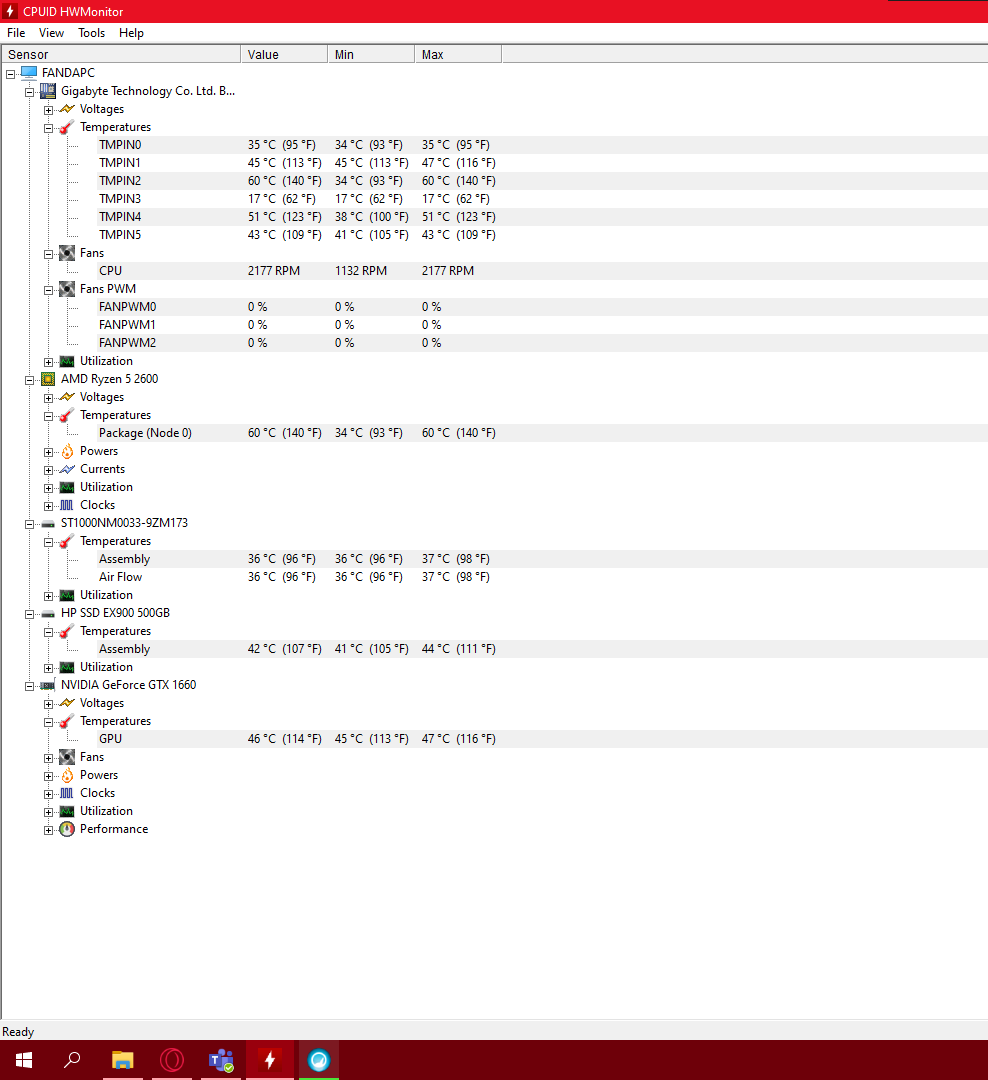

Teplota procesoru v zátěži se pohybuje okolo 65 stupňů (aplikace Core Temp) ,
Tady je screenshot z HW monitor
Základní deska B450M DS3H-CF
Procesor AMD Ryzen 5 2600 Six-Core Processor, 3400 Mhz, jádra: 6, logické procesory: 12
Nainstalovaná fyzická paměť (RAM) 16,0 GB
RAM G.SKILL 16GB KIT DDR4 3200MHz CL16 Gaming series Aegis
Grafická karta Gigabyte Geforce GTX 1660 oc 6g
Zdroj Cooler Master ELITE 600W 230V - V3
Blue screen Vyřešeno

(02) HP SSD EX900 500GB
Model : HP SSD EX900 500GB
Firmware : S0614B0
Serial Number : HBSE39511200344
Disk Size : 500,1 GB
Buffer Size : Neznámy údaj
# of Sectors :
Rotation Rate : ---- (SSD)
Interface : NVM Express
Major Version : NVM Express 1.3
Minor Version :
Transfer Mode : PCIe 3.0 x4 | PCIe 3.0 x4
Power On Hours : 166 hod.
Power On Count : 57 krát
Host Reads : 1260 GB
Host Writes : 627 GB
Temperature : 44 C (111 F)
Health Status : Dobrý (100 %)
Features : S.M.A.R.T., TRIM, VolatileWriteCache
APM Level : ----
AAM Level : ----
Drive Letter : C:
ID RawValues(6) Attribute Name
01 000000000000 Critical Warning
02 00000000013D Composite Temperature
03 000000000064 Available Spare
04 00000000000A Available Spare Threshold
05 000000000000 Percentage Used
06 00000028556E Data Units Read
07 00000014127A Data Units Written
08 00000184391C Host Read Commands
09 000000D7DAC0 Host Write Commands
0A 000000000397 Controller Busy Time
0B 000000000039 Power Cycles

CrystalDiskInfo 8.9.0 (C) 2008-2020 hiyohiyo
Crystal Dew World: https://crystalmark.info/
OS : Windows 10 [10.0 Build 19041] (x64)
Date : 2021/01/11 11:04:45
+ Standardní řadič SATA AHCI [ATA]
- ST1000NM0033-9ZM173
- AMD SATA Controller [ATA]
+ Řadič Standard NVM Express [SCSI]
- HP SSD EX900 500GB
(01) ST1000NM0033-9ZM173 : 1000,2 GB [0/0/0, pd1]
(02) HP SSD EX900 500GB : 500,1 GB [1/1/0, sq] - nv
Model : ST1000NM0033-9ZM173
Firmware : SN04
Serial Number : Z1W38ASQ
Disk Size : 1000,2 GB (8,4/137,4/1000,2/1000,2)
Queue Depth : 32
# of Sectors : 1953525168
Rotation Rate : 7200 RPM
Interface : Serial ATA
Major Version : ACS-2
Minor Version : ----
Transfer Mode : SATA/600 | SATA/600
Power On Hours : 22588 hod.
Power On Count : 12091 krát
Temperature : 36 C (96 F)
Features : S.M.A.R.T., NCQ
APM Level : ----
AAM Level : ----
Drive Letter : D:

Na tom HDD je 16 přemapovaných sektorů, což je ale vzhledem k více než 22 000 hodinám provozu ještě hodně dobrý stav. Na disk bych to nesvalol, jelikož není systémový, ale vyměnit už by asi zasloužil.
