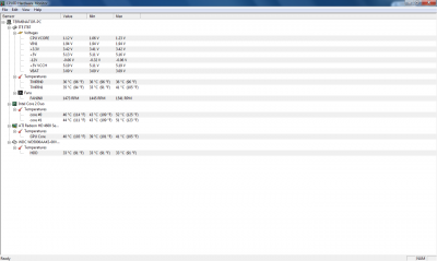

Zkus sem hodit teploty z HWmonotoru, jestli se to náhodou nepřehřívá.
Re: Nenačítají mi hry, občas se počítač sekne při načítání
CPUID Hardware Monitor 1.1.0.0
Mainboard Vendor Gigabyte Technology Co., Ltd.
Mainboard Model EP41-UD3L (0x23F - 0x2D7A9E8)
LPCIO
Vendor ITE
Model IT8718
Vendor ID 0x90
Chip ID 0x8718
Revision ID 0x8
Config Mode I/O address 0x2E
Dump config mode register space, LDN = 0x4
0 1 2 3 4 5 6 7 8 9 A B C D E F
00 00 00 00 00 00 00 00 04 00 00 00 00 00 00 00 00
10 00 00 00 00 00 00 00 00 00 00 00 00 00 00 00 00
20 87 18 08 00 00 80 FF 1B 41 88 00 00 01 00 00 00
30 01 00 00 00 00 00 00 00 00 00 00 00 00 00 00 00
40 00 00 00 00 00 00 00 00 00 00 00 00 00 00 00 00
50 00 00 00 00 00 00 00 00 00 00 00 00 00 00 00 00
60 02 90 00 00 00 00 00 00 00 00 00 00 00 00 00 00
70 00 02 00 00 04 04 00 00 00 00 00 00 00 00 00 00
Hardware monitor
ITE IT87 hardware monitor
Voltage sensor 0 1.07 Volts [0x43] (CPU VCORE)
Voltage sensor 1 1.94 Volts [0x79] (VIN1)
Voltage sensor 2 3.42 Volts [0xD6] (+3.3V)
Voltage sensor 3 5.13 Volts [0xBF] (+5V)
Voltage sensor 5 -0.06 Volts [0x1] (-12V)
Voltage sensor 7 5.19 Volts [0xC1] (+5V VCCH)
Voltage sensor 8 3.09 Volts [0xC1] (VBAT)
Temperature sensor 0 36°C (96°F) [0x24] (TMPIN0)
Temperature sensor 1 33°C (91°F) [0x21] (TMPIN1)
Fan sensor 0 1474 RPM [0x1CA] (FANIN0)
Dump hardware monitor
LPC Register space, base address = 0x0290
00 13 10 50 00 FF FF 00 37 FF 87 58 09 17 CA FF FF
10 FF FF FF 76 D7 FD FC FD 01 FF FF FF FF FF FF FF
20 43 79 D6 BF 00 01 FF C1 C1 24 21 FE 80 8A BB BB
30 FF 00 FF 00 FF 00 FF 00 FF 00 FF 00 FF 00 FF 00
40 7F 7F 7F 7F 7F 7F 5F 74 2D 40 9C 22 FF FF FF FF
50 FF 2A 7F 7F 7F 50 FA FA 90 FA 00 12 60 00 00 00
60 00 14 41 23 90 03 FF FF 00 14 41 23 90 03 FF FF
70 00 14 41 23 90 03 FF FF FF FF FF FF FF FF FF FF
80 FF FF 00 00 FF FF 00 00 00 00 00 00 00 00 02 00
90 FF 00 00 00 FF 00 00 00 FF FF FF FF FF FF FF FF
A0 00 00 00 00 00 00 00 FF FF FF FF FF FF FF FF FF
B0 FF FF FF FF FF FF FF FF FF FF FF FF FF FF FF FF
C0 FF FF FF FF FF FF FF FF FF FF FF FF FF FF FF FF
D0 FF FF FF FF FF FF FF FF FF FF FF FF FF FF FF FF
E0 FF FF FF FF FF FF FF FF FF FF FF FF FF FF FF FF
F0 FF FF FF FF FF FF FF FF FF FF FF FF FF FF FF FF
Hardware monitor
Intel Core 2 Duo hardware monitor
Temperature sensor 0 43°C (109°F) [0x3E] (core #0)
Temperature sensor 1 43°C (109°F) [0x3E] (core #1)
Hardware monitor
ATI Radeon HD 4600 Series hardware monitor
Temperature sensor 0 40°C (103°F) [0x28] (GPU Core)
Hardware monitor
WDC WD5000AAKS-00V1A0 hardware monitor
Temperature sensor 0 33°C (91°F) [0x21] (HDD)

Stačí to takhle ?
LPCIO
Vendor ITE
Model IT8718
Vendor ID 0x90
Chip ID 0x8718
Revision ID 0x8
Hardware monitor
Hardware monitor
Hardware monitor
Hardware monitor
To jsou teploty v klidu?
vím že je to blbá otázka ae jak tu mám dát obrázek ?
Jako přílohu
Jo je to vpohodě, teplotou to nebude... (btw máš Intel celeron s 22.5 GHz?
