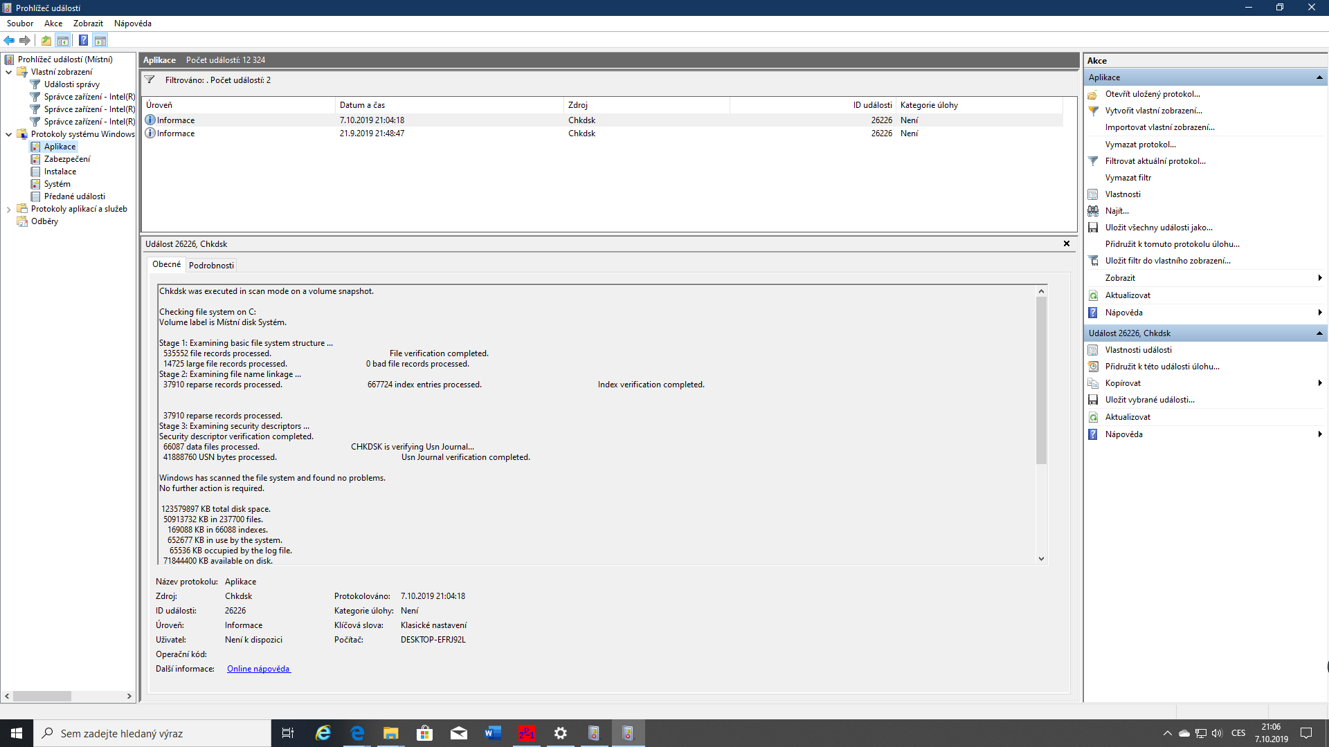

Tohle mi píše systémová kontrola v příkazovém řádku:
Windows Resource Protection found corrupt files and successfully repaired them.
For online repairs, details are included in the CBS log file located at
windir\Logs\CBS\CBS.log. For example C:\Windows\Logs\CBS\CBS.log. For offline
repairs, details are included in the log file provided by the /OFFLOGFILE flag.

Microsoft Windows [Version 10.0.18362.388]
(c) 2019 Microsoft Corporation. Všechna práva vyhrazena.
C:\WINDOWS\system32>sfc/scannow
Beginning system scan. This process will take some time.
Beginning verification phase of system scan.
Verification 100% complete.
C:\WINDOWS\system32>chkdsk
The type of the file system is NTFS.
Volume label is Místní disk Systém.
WARNING! /F parameter not specified.
Running CHKDSK in read-only mode.
Stage 1: Examining basic file system structure ...
535552 file records processed.
File verification completed.
14725 large file records processed.
0 bad file records processed.
Stage 2: Examining file name linkage ...
37902 reparse records processed.
667672 index entries processed.
Index verification completed.
0 unindexed files scanned.
0 unindexed files recovered to lost and found.
Stage 3: Examining security descriptors ...
Security descriptor verification completed.
66061 data files processed.
CHKDSK is verifying Usn Journal...
40368752 USN bytes processed.
Usn Journal verification completed.
Windows has scanned the file system and found no problems.
No further action is required.
123579897 KB total disk space.
50737636 KB in 236269 files.
168576 KB in 66062 indexes.
0 KB in bad sectors.
651141 KB in use by the system.
65536 KB occupied by the log file.
72022544 KB available on disk.
4096 bytes in each allocation unit.
30894974 total allocation units on disk.
18005636 allocation units available on disk.
Dodatečně přidáno po 7 minutách 36 vteřinách:
Na disku C: mám SSD 128 GB a Battlefielda V mám na disku s 1TB , není to SSDisk, ale obyčejný HDD.

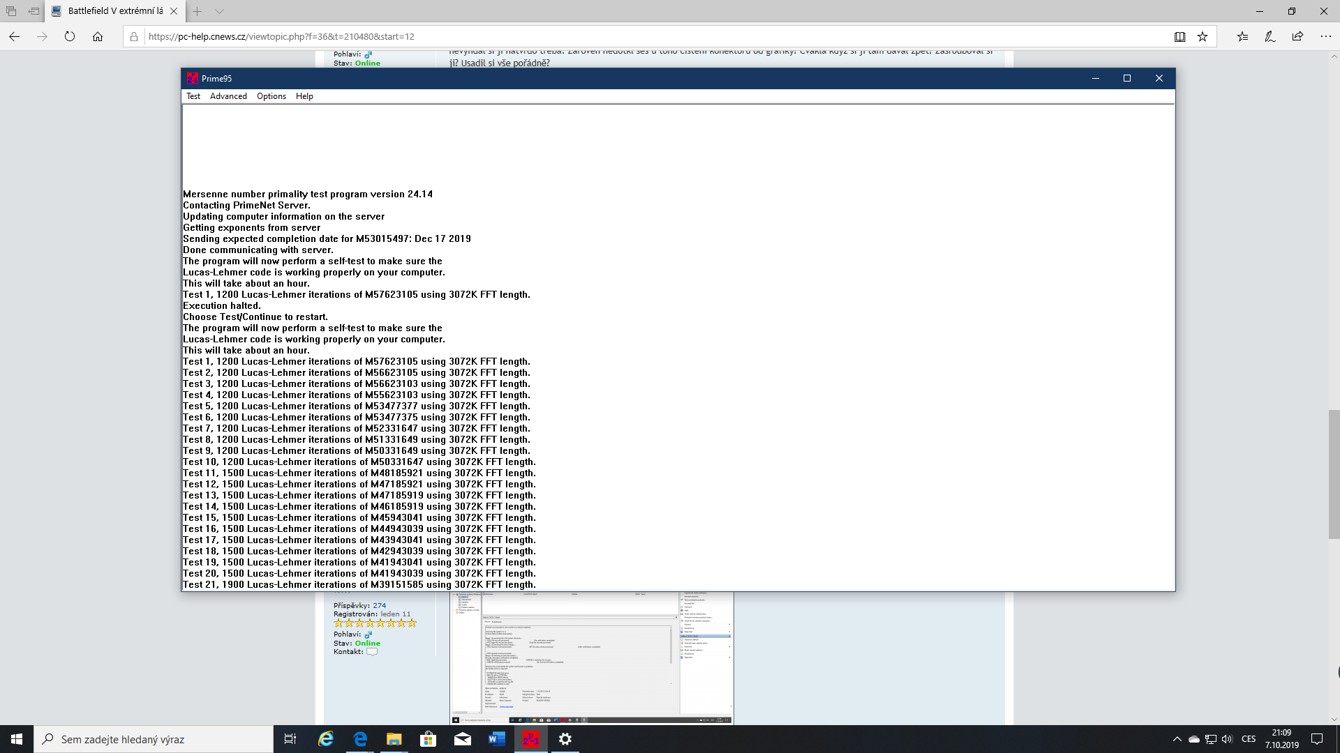

Ano, odpojil jsem zdroj od elektřiny, vše bylo řádně odmontované a namontované. Teď to běží, ale nemělo by to takto dělat. Vyzkouším ještě ty ramky a furmark.
Dodatečně přidáno po 15 minutách 57 vteřinách:
Teď zkouším ten test procesoru a ramek, píše to 1 hodina do konce testu......
Re: Battlefield V extrémní lágy
Pokud pc nenajede napoprvé, tak něco "nepostlo", Většinou to bývají právě ramky. Nemáš náhodou taktovaný ani procák ani grafiku? Určitě proved ty zátěžové testy jak ramek, tak procáku, tak grafiky. Ramky a disk projed nějakým diagnostickým programem - jak už jsem ti psal, nějakým pořádným ověřeným extérním programem, ne windows utilitkou, i když třeba může být sebelepší.
Není, to je stará verze. Stáhni v29.8, build 6. Torture test small je na procesor. Na rychlý test, když vydrží 20 minut, tak by mohl být ok. Large otestuje ramky. Zase když vydrží tak 20 minut, jsou snad stabilní. Vypni dole radši všechny AVX a kontroluj u toho teploty.
