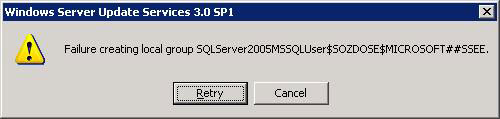

Zdravim, mam problem s instalaci WSUS na Windows Server 2003. Pri instalaci WSUSu vyskoci tahle chybova hlaska (viz obrazek)
Prikladam jeste log z instalace:
2009-02-04 12:30:28 Success MWUSSetup Validating pre-requisites...
2009-02-04 12:30:29 Error MWUSSetup Failed to determine if an higher version of WSUS is installed. Assuming it is not... (Error 0x80070002: The system cannot find the file specified.)
2009-02-04 12:30:31 Success MWUSSetup ReportViewer is not installed on this machine
2009-02-04 12:30:32 Success MWUSSetup No SQL instances found
2009-02-04 12:30:35 Success MWUSSetup Initializing installation details
2009-02-04 12:30:35 Success MWUSSetup Installing ASP.Net
2009-02-04 12:31:07 Success MWUSSetup ASP.Net is installed successfully
2009-02-04 12:31:07 Success MWUSSetup Installing wYukon using MSI on Win2k3
2009-02-04 12:31:07 Success MWUSSetup Installing wYukon...
2009-02-04 12:32:36 Error MWUSSetup InstallWyukon: wYukon Installation Failed (Error 0x80070643: Fatal error during installation.)
2009-02-04 12:32:36 Error MWUSSetup CInstallDriver::PerformSetup: Installation of wYukon failed (Error 0x80070643: Fatal error during installation.)
2009-02-04 12:32:36 Error MWUSSetup CSetupDriver::LaunchSetup: Setup failed (Error 0x80070643: Fatal error during installation.)
2009-02-04 12:32:39 Error MWUSSetup DoInstall: Wsus setup failed (Error 0x80070643: Fatal error during installation.)
Kdyby nahodou nekdo vedel, co s tim, budu rad :-)

na tohle zrovna odbornik nejsem, ale podle logu je chyba pri nastaveni Windows Internal database,... zkusit odebrat Windows Internal Database podle, http://support.microsoft.com/kb/920277, pak restartovat server, a zkusit instalaci znovu? aspon podobny postup doporucovali kolegove spravci site :-)
