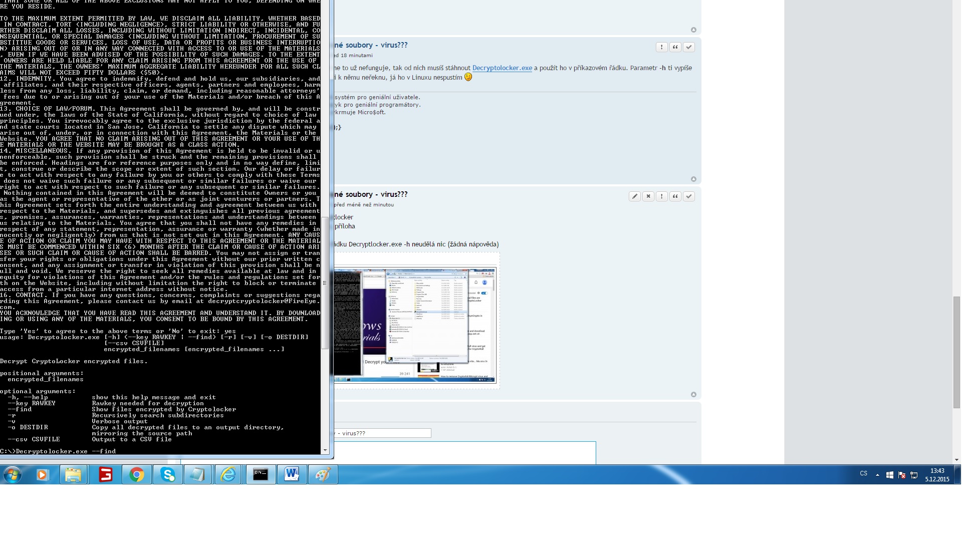

Koukám že online to už nefunguje, tak od nich musíš stáhnout Decryptolocker.exe a použít ho v příkazovém řádku. Parametr -h ti vypíše nápovědu. Víc ti k němu neřeknu, já ho v Linuxu nespustím
Re: Zašifrované soubory - virus???
Spustím Decryptlocker
a stane se: viz. příloha
V příkazovém řádku Decryptlocker.exe -h
Zkopíruj k němu do adresáře nějakou zašifrovanou fotku a předhoď mu jí:
A uvidíme jestli si s tím poradí nebo je to nějaká nová šifra.
Kód: Vybrat vše
decryptolocker fotka.jpgA uvidíme jestli si s tím poradí nebo je to nějaká nová šifra.
Toto se stane
C:\>Decryptolocker fotka.jpg

Type 'Yes' to agree to the above terms or 'No' to exit: Yes
usage: Decryptolocker.exe [-h] (--key RAWKEY | --find) [-r] [-v] [-o DESTDIR]
[--csv CSVFILE]
encrypted_filenames [encrypted_filenames ...]
Decryptolocker.exe: error: one of the arguments --key --find is required
C:\>
crypto-un-locker

ploaded, if our software is able to provide a decryption key to the encrypted Cr
yptoLocker file, then We will email you the decryption and provide you with an o
ption to download an executable file used to decrypt the affected files. If We a
re able to provide you with a decryption key, We will use reasonable endeavours
to provide you with the key and an executable file to download as soon as possib
le and usually this will be within one (1) to twenty-four (24) hours of you uplo
ading the encrypted CryptoLocker file. When you execute this file on your comput
er with the provided decryption key, it will decrypt the encrypted CryptoLocker
file. Delivery will be by means of your downloading the executable file only fro
m the Website. We make no guarantee and do not warrant that the executable file
or decryption key will be able to decrypt your encrypted files. Once you have do
wnloaded the executable file, you acknowledge that We will have completed our ob
ligations to you in providing the Decryption Services in respect of the particul
ar file you uploaded and you acknowledge that you will not be permitted to cance
l the supply of the Decryption Services.
8. EXPORT COMPLIANCE. You agree that you will not, directly or indirectly, ship
, transfer, transmit, export or re-export, or knowingly permit any of the forego
ing with respect to the Materials, or any technical information about the Materi
als, to any country for which the United States Export Administration Act, any r
egulation thereunder, or any similar United States law or regulation, requires a
n export license or other United States Government approval, unless the appropri
ate export license or approval has been obtained. Delivery of Materials does no
t imply third-party authority to import, distribute, or use encryption. Importer
s, distributors, customers and users are responsible for compliance with all loc
al country laws. The Owners strongly recommend that importers, distributors, and
users investigate such regulations prior to encryption product deployment.
9. TERMINATION. You may terminate this Agreement at any time by deleting all co
pies of the Materials from your systems, networks and devices. Owners may termin
ate this Agreement at any time by providing you with individual notice, or by po
sting a notice on the Website. When this Agreement terminates or expires, all ri
ghts granted to you will cease, and you must immediately destroy or purge from y
our computer system the Materials and all copies in your possession.
10. TRADEMARKS. Unauthorized use of any of our trademarks, service marks or logo
s are prohibited, and may constitute a violation of applicable law, including wi
thout limitation federal and state trademark laws.
11. DISCLAIMERS AND LIMITATION OF LIABILITY. THE MATERIALS ARE PROVIDED TO YOU O
N AN "AS IS" "AS AVAILABLE" BASIS WITHOUT WARRANTY OR CONDITION OF ANY KIND EITH
ER EXPRESS OR IMPLIED. We specifically disclaim all warranties and conditions of
any kind including without limitation all implied warranties and conditions of
merchantability, fitness for a particular purpose, title, freedom from defects,
accuracy, uninterrupted use, non-infringement and all warranties implied from an
y course of dealing or usage of trade. We make no warranty that (a) the Material
s will meet your requirements, (b) use of the Materials will be uninterrupted or
virus- or error-free; (c) errors will be corrected; or (d) as to the accuracy,
completeness or reliability of the Materials. You are responsible for verifying
any information before relying on it. Use of the Materials is at your sole risk.
SOME JURISDICTIONS DO NOT ALLOW THE EXCLUSION OF IMPLIED WARRANTIES WHICH MEANS
THAT SOME OR ALL OF THE ABOVE EXCLUSIONS MAY NOT APPLY TO YOU, DEPENDING ON WHE
RE YOU RESIDE.
TO THE MAXIMUM EXTENT PERMITTED BY LAW, WE DISCLAIM ALL LIABILITY, WHETHER BASED
IN CONTRACT, TORT (INCLUDING NEGLIGENCE), STRICT LIABILITY OR OTHERWISE, AND FU
RTHER DISCLAIM ALL LOSSES, INCLUDING WITHOUT LIMITATION INDIRECT, INCIDENTAL, CO
NSEQUENTIAL, OR SPECIAL DAMAGES (INCLUDING WITHOUT LIMITATION, PROCUREMENT OF SU
BSTITTUE GOODS OR SERVICES, LOSS OF USE, DATA OR PROFITS OR BUSINESS INTERRUPTIO
N) ARISING OUT OF OR IN ANY WAY CONNECTED WITH ACCESS TO OR USE OF THE MATERIALS
, EVEN IF WE HAVE BEEN ADVISED OF THE POSSIBILITY OF SUCH DAMAGES. TO THE EXTENT
OWNERS ARE HELD LIABLE FOR ANY CLAIM ARISING FROM THIS AGREEMENT OR THE USE OF
THE MATERIALS, THE OWNERS' MAXIMUM AGGREGATE LIABILITY HEREUNDER FOR ALL SUCH CL
AIMS WILL NOT EXCEED FIFTY DOLLARS ($50).
12. INDEMNITY. You agree to indemnify, defend and hold us, our subsidiaries, and
affiliates, and their respective officers, agents, partners and employees, harm
less from any loss, liability, claim, or demand, including reasonable attorneys'
fees due to or arising out of your use of the Materials and/or breach of this A
greement.
13. CHOICE OF LAW/FORUM. This Agreement shall be governed by, and will be constr
ued under, the laws of the State of California, without regard to choice of law
principles. You irrevocably agree to the exclusive jurisdiction by the federal a
nd state courts located in San Jose, California to settle any dispute which may
arise out of, under, or in connection with this Agreement, the Materials or the
Website. YOU AGREE THAT NO CLAIM ARISING OUT OF THIS AGREEMENT OR YOUR USE OF TH
E MATERIALS OR THE WEBSITE MAY BE BROUGHT AS A CLASS ACTION.
14. MISCELLANEOUS. If any provision of this Agreement is held to be invalid or u
nenforceable, such provision shall be struck and the remaining provisions shall
be enforced. Headings are for reference purposes only and in no way define, limi
t, construe or describe the scope or extent of such section. Our delay or failur
e to act with respect to any failure by you or others to comply with these Terms
does not waive such failure or any subsequent or similar failures or waive our
right to act with respect to such failure or any subsequent or similar failures.
Nothing contained in this Agreement will be deemed to constitute Owners or you
as the agent or representative of the other or as joint venturers or partners. T
his Agreement sets forth the entire understanding and agreement between us with
respect to the Materials, and supersedes and extinguishes all previous agreement
s, promises, assurances, warranties, representations and understandings between
us relating to the Materials. You agree that you shall not have any remedies in
respect of any statement, representation, assurance or warranty (whether made in
nocently or negligently) from us that is not set out in this Agreement. ANY CAUS
E OF ACTION OR CLAIM YOU MAY HAVE WITH RESPECT TO THIS AGREEMENT OR THE MATERIAL
S MUST BE COMMENCED WITHIN SIX (6) MONTHS AFTER THE CLAIM OR CAUSE OF ACTION ARI
SES OR SUCH CLAIM OR CAUSE OF ACTION SHALL BE BARRED. You may not assign or tran
sfer your rights or obligations under this Agreement without our prior written c
onsent, and any assignment or transfer in violation of this provision shall be n
ull and void. We reserve the right to seek all remedies available at law and in
equity for violations of this Agreement and/or the rules and regulations set for
th on the Website, including without limitation the right to block or terminate
access from a particular internet address without notice.
16. CONTACT. If you have any questions, concerns, complaints or suggestions rega
rding this Agreement, please contact us by email at decryptcryptolocker@FireEye.
com.
YOU ACKNOWLEDGE THAT YOU HAVE READ THIS AGREEMENT AND UNDERSTAND IT. BY DOWNLOAD
ING OR USING ANY OF THE MATERIALS, YOU CONSENT TO BE BOUND BY THIS AGREEMENT.
[--csv CSVFILE]
C:\>
