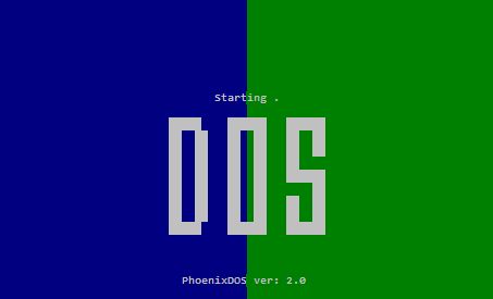

Ouha, a není nějaký jednoduchý DOS program, který ti na určenou dobu zobrazí obrázek?
Nebo by mi stačil návod ...

Jsem zde. A mám ukázku hotovou a zabudovanou v systému
Výsledek je tady na tom obrázku:
Kód: Vybrat vše
@echo off
set ver=2.0
:vymazani obrazu
BE CLS
:okno
BE ROWCOL 0 0 " " WHITE ON BLUE
BE ROWCOL 1 0 " " WHITE ON BLUE
BE ROWCOL 2 0 " " WHITE ON BLUE
BE ROWCOL 3 0 " " WHITE ON BLUE
BE ROWCOL 4 0 " " WHITE ON BLUE
BE ROWCOL 5 0 " " WHITE ON BLUE
BE ROWCOL 6 0 " " WHITE ON BLUE
BE ROWCOL 7 0 " " WHITE ON BLUE
BE ROWCOL 8 0 " " WHITE ON BLUE
BE ROWCOL 9 0 " " WHITE ON BLUE
BE ROWCOL 10 0 " " WHITE ON BLUE
BE ROWCOL 11 0 " " WHITE ON BLUE
BE ROWCOL 12 0 " " WHITE ON BLUE
BE ROWCOL 13 0 " " WHITE ON BLUE
BE ROWCOL 14 0 " " WHITE ON BLUE
BE ROWCOL 15 0 " " WHITE ON BLUE
BE ROWCOL 16 0 " " WHITE ON BLUE
BE ROWCOL 17 0 " " WHITE ON BLUE
BE ROWCOL 18 0 " " WHITE ON BLUE
BE ROWCOL 19 0 " " WHITE ON BLUE
BE ROWCOL 20 0 " " WHITE ON BLUE
BE ROWCOL 21 0 " " WHITE ON BLUE
BE ROWCOL 22 0 " " WHITE ON BLUE
BE ROWCOL 0 38 " " WHITE ON GREEN
BE ROWCOL 1 38 " " WHITE ON GREEN
BE ROWCOL 2 38 " " WHITE ON GREEN
BE ROWCOL 3 38 " " WHITE ON GREEN
BE ROWCOL 4 38 " " WHITE ON GREEN
BE ROWCOL 5 38 " " WHITE ON GREEN
BE ROWCOL 6 38 " " WHITE ON GREEN
BE ROWCOL 7 38 " " WHITE ON GREEN
BE ROWCOL 8 38 " " WHITE ON GREEN
BE ROWCOL 9 38 " " WHITE ON GREEN
BE ROWCOL 10 38 " " WHITE ON GREEN
BE ROWCOL 11 38 " " WHITE ON GREEN
BE ROWCOL 12 38 " " WHITE ON GREEN
BE ROWCOL 13 38 " " WHITE ON GREEN
BE ROWCOL 14 38 " " WHITE ON GREEN
BE ROWCOL 15 38 " " WHITE ON GREEN
BE ROWCOL 16 38 " " WHITE ON GREEN
BE ROWCOL 17 38 " " WHITE ON GREEN
BE ROWCOL 18 38 " " WHITE ON GREEN
BE ROWCOL 19 38 " " WHITE ON GREEN
BE ROWCOL 20 38 " " WHITE ON GREEN
BE ROWCOL 21 38 " " WHITE ON GREEN
BE ROWCOL 22 38 " " WHITE ON GREEN
:vykres
BE ROWCOL 7 19 " Starting . " WHITE
:dosvykres
:d
BE ROWCOL 09 26 " " WHITE ON WHITE
BE ROWCOL 10 26 " " WHITE ON WHITE
BE ROWCOL 11 26 " " WHITE ON WHITE
BE ROWCOL 12 26 " " WHITE ON WHITE
BE ROWCOL 13 26 " " WHITE ON WHITE
BE ROWCOL 14 26 " " WHITE ON WHITE
BE ROWCOL 15 26 " " WHITE ON WHITE
BE ROWCOL 16 26 " " WHITE ON WHITE
BE ROWCOL 17 26 " " WHITE ON WHITE
BE ROWCOL 7 19 " Starting .. " WHITE
BE ROWCOL 10 30 " " WHITE ON WHITE
BE ROWCOL 11 30 " " WHITE ON WHITE
BE ROWCOL 12 30 " " WHITE ON WHITE
BE ROWCOL 13 30 " " WHITE ON WHITE
BE ROWCOL 14 30 " " WHITE ON WHITE
BE ROWCOL 15 30 " " WHITE ON WHITE
BE ROWCOL 16 30 " " WHITE ON WHITE
BE ROWCOL 7 19 " Starting ... " WHITE
:o
BE ROWCOL 09 35 " " WHITE ON WHITE
BE ROWCOL 10 35 " " WHITE ON WHITE
BE ROWCOL 11 35 " " WHITE ON WHITE
BE ROWCOL 12 35 " " WHITE ON WHITE
BE ROWCOL 13 35 " " WHITE ON WHITE
BE ROWCOL 14 35 " " WHITE ON WHITE
BE ROWCOL 15 35 " " WHITE ON WHITE
BE ROWCOL 16 35 " " WHITE ON WHITE
BE ROWCOL 17 35 " " WHITE ON WHITE
BE ROWCOL 10 39 " " WHITE ON WHITE
BE ROWCOL 11 39 " " WHITE ON WHITE
BE ROWCOL 12 39 " " WHITE ON WHITE
BE ROWCOL 13 39 " " WHITE ON WHITE
BE ROWCOL 14 39 " " WHITE ON WHITE
BE ROWCOL 15 39 " " WHITE ON WHITE
BE ROWCOL 16 39 " " WHITE ON WHITE
:s
BE ROWCOL 9 44 " " WHITE ON WHITE
BE ROWCOL 10 44 " " WHITE ON WHITE
BE ROWCOL 11 44 " " WHITE ON WHITE
BE ROWCOL 12 44 " " WHITE ON WHITE
BE ROWCOL 13 44 " " WHITE ON WHITE
BE ROWCOL 17 44 " " WHITE ON WHITE
BE ROWCOL 15 44 " " WHITE ON WHITE
BE ROWCOL 16 44 " " WHITE ON WHITE
BE ROWCOL 10 48 " " WHITE ON WHITE
BE ROWCOL 11 48 " " WHITE ON WHITE
BE ROWCOL 14 48 " " WHITE ON WHITE
BE ROWCOL 15 48 " " WHITE ON WHITE
BE ROWCOL 16 48 " " WHITE ON WHITE
:posledni
BE ROWCOL 21 19 " PhoenixDOS ver: %ver% " WHITE

Re: Pomoc s jednoduchým operačním systémem
Překlad nápovědy:
BE příkaz [parametry]
nebo
BE soubor
Použitelné příkazy:
ASK
BEEP
BOX
CLS
DELAY
PRINTCHAR
ROWCOL
SA
WINDOW
Pro podrobnější nápovědu pište:
BE příkaz ?
BE ASK "výzva" [seznam kláves] [DEFAULT=klávesa] [TIMEOUT=n] [ADJUST=n] [barva]
Něco jako CHOICE, ale s mnohem víc možnostmi, hlavně v barevném výpisu textů. Default je klávesa která se vybere automaticky po vypršení Timeoutu, co dělal Adjust si nevzpomínám, můžeš si hrát a přijít na to
BEEP [přepínače]
nebo
BEEP [soubor]
/Dn Délka tónu v n/18 sekundy
/Fn Frekvence tónu
/Rn Opakování tónu n krát
/Wn Čekání mezi tóny v n/18 sekundy
Prostě pípne něco z notové stupnice a v určité délce. Dokáže to zahrát jednoduchou melodii.
BE BOX nahoře vlevo dole vpravo [barva]
Nakreslí rámeček kolem textu, ze zadanou vzdáleností od okrajů obrazovky, případně v udané barvě.
BE CLS
Na smazání obrazovky není co řešit, na to sice v DOSu příkaz je, ale když už to BE umí interně, tak proč to nepřidat.
BE DELAY tiků (1 tik = 1/18 sekundy)
Čekání před další činností.
BE PRINTCHAR znak počet [barva]
Napíše zadaný znak, kolikrát chceš, v zadané barvě.
BE ROWCOL řádek sloupec ["text"] [barva]
Vypíše text do zvoleného místa obrazovky a v určité barvě.
SA styl [/N]
nebo
SA [intenzita][popředí][ON pozadí][/N][/C]
Volby pro intenzitu
Bright Bold Blinking
Volby pro styl
Normal Reverse Underline
Volby pro popředí a pozadí
White Black Red Magenta
Blue Green Cyan Yellow
Přepínače
/N Nenastavovat barvu okraje obrazovky
/C Smazat obrazovku
Screen Attributes je nejsložitější příkaz, ale sám vidíš co všechno se tím dá nastavit. Prakticky není nic co by se nedalo udělat tady stejně jako v tom QBasicu! Dokonce to umí navrch měnit border, což QB nedovedl, přestože v nápovědě to bylo a starší GWBasic to dělal.
BE WINDOW nahoře vlevo dole vpravo [barva] [EXPLODE] [SHADOW]
Zobrazí okno (podobně jako rámeček ale přepíše obsah uvnitř) se zadanou vzdáleností od okrajů obrazovky a barvou, jako zvláštní efekty lze použít explodování (nafouknutí se) a stín okraje.
Na prográmek z roku 1988 který má 20 kilobajtů a jede na 8086 to umí hromadu věcí, dneska by na to bylo potřeba minimálně deset mega a dvoujádrový procesor
Ale načítání na pozadí v DOSu nehrozí, to je věc kterou M$ sliboval už od půlky osmdesátých let, konkurenti dokonce prodávali pluguin který to bez problémů umožňoval, ale do MS-DOSu se to nikdy nedostal. Redmondské sliby... (Příští systém bude dokonalý, stabilní a bezpečný
Ještě jsem to trochu upravil.
A nejde něco jako, že bych napsal "loadfix Start.bat" a při nahrávání do paměti by se zapínaly ty programy z AUTOEXEC.BAT?
Jinak - startovní screenek dobrý ???
Nebo. Dá se ten plugin stáhnout?

Screen je pěkný :)

TAKŽE, naštval jsem se. A vytvořil další odvětví PhoenixDOSu (PhoenixDOS 3.0). Obsahuje kompletní grafickou nadstavbu. Už nepracuje v textovem režimu
. PhoenixDOS 2.0 nechám, a budu ho vyvíjet zvlášť
Ještě, je nějaký prográmek, který vypne PC, když ho zapneš? Jako, že šáhne na zdroj a zhasne ho...
Systém uploadnu potom...
--- Doplnění předchozího příspěvku (24 Srp 2011 18:29) ---
Tady je ten nový
http://2fun.xf.cz/PhoenixOS%203.1.zip
--- Doplnění předchozího příspěvku (24 Srp 2011 21:31) ---
Tak už to je jako ve Windows 3.1
