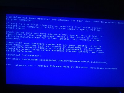

Zdravím pánové,
měl bych takovou otázku, asi bude málo informací, ale když zapnu počítač, tak po chvilce hodí modrou smrt
nějaké anglické kecy ..
ten ,,Kód" 0x000....
physical disk a začne tam skákat 15, 30, 45, 60, 75, 90 a 100 jak skočí 100 tak se restartuje Pc a zas po chviličce opět to samé..
nevíte co by mohlo odejít?

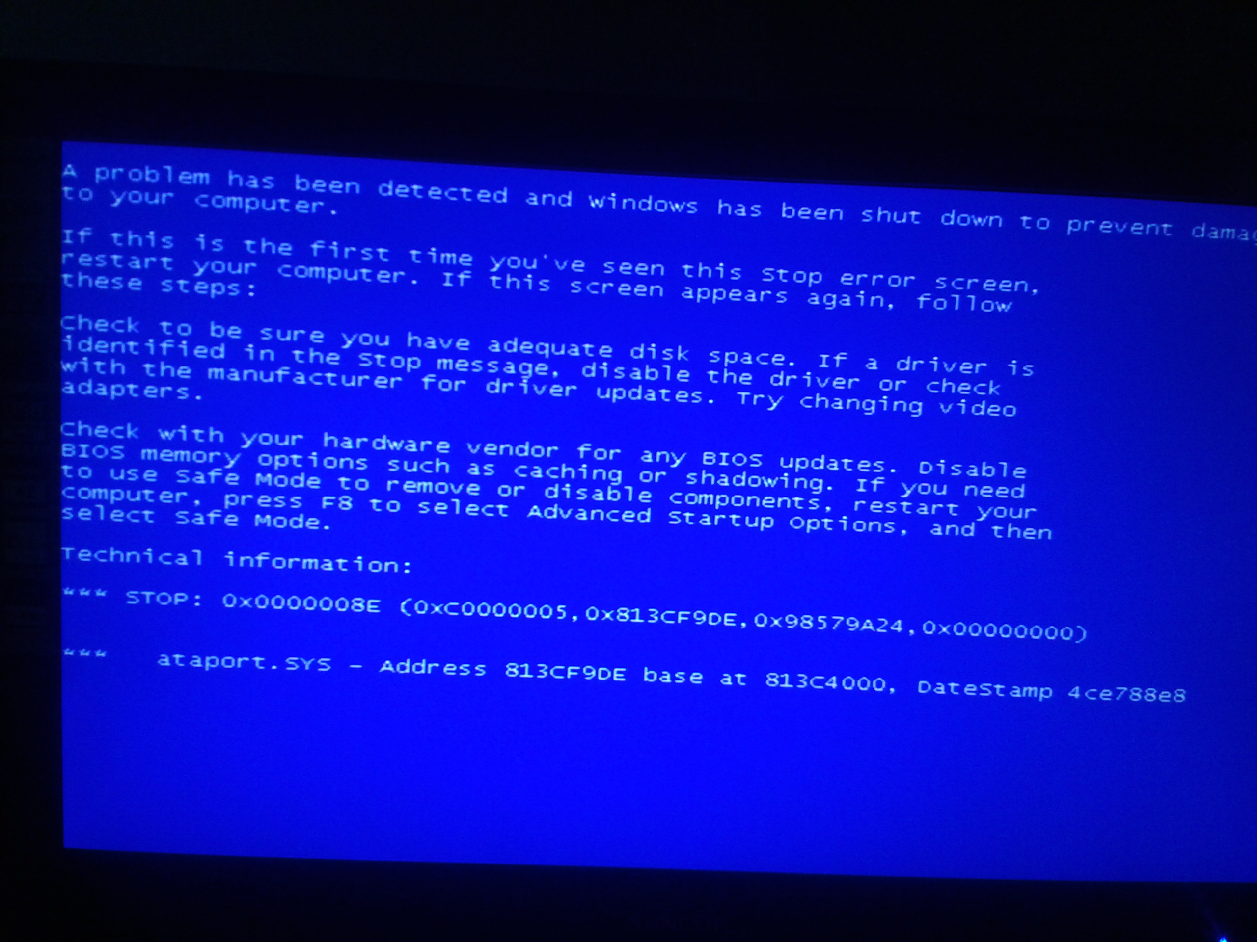

Teď to napsalo:
A problem has been detected and windows has been shut down to prevent damage to your computer.
If this is the first time youve seen this Stop error screen, restart computer. If this screen appears again, follow these steps:
Check to be suer you have adequate disk space. If a driver is identified in the Stop message, disable the driver or chcek with the manufacturer for driver updates. Try changing video adapters.
Check with your hardare vendor for any BIOS updates. Disable to use safe mode to revove or disable components, restart your computer, press F8 to select Advanced Startup Options, and then select Safe Mode
STOP: 0x0000008E (0xC0000005, 0x813CF9DE, 0x98579A24, 0x000000000)

Příspěvekod SkLuky » 05 zář 2013 19:57
Origo
