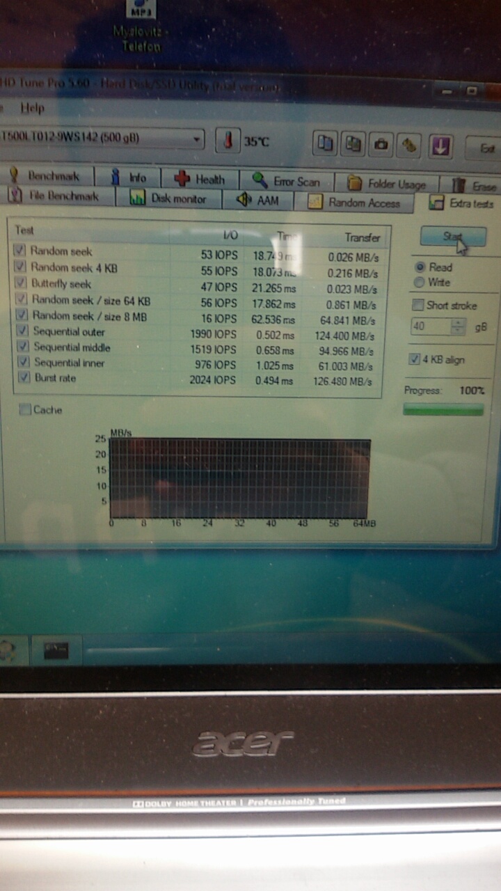

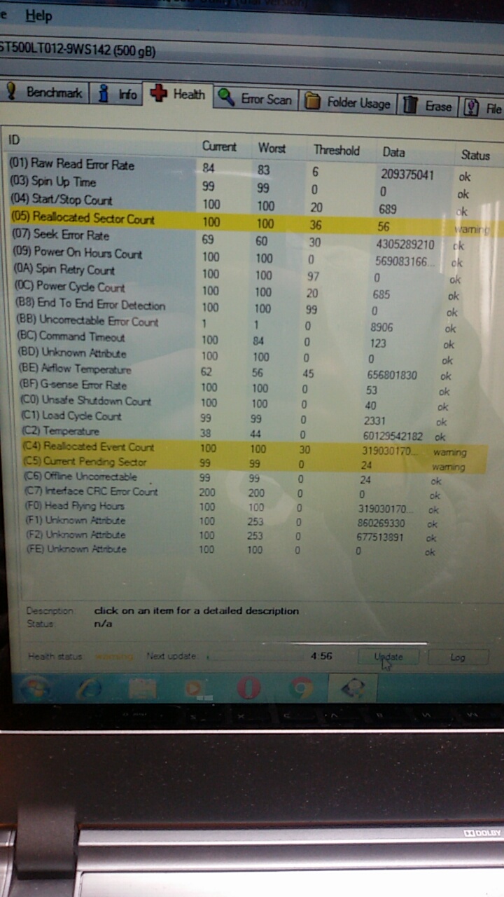

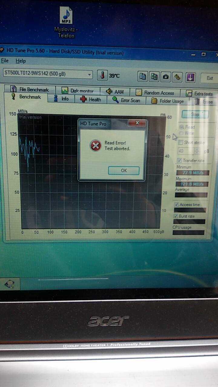

My problem with laptop acer aspire M is kinda weird. I took the comp from my gf (idk how many days she didnt shutdown it, even weeks or months) and i shutdownit then a few hours later i lunched it and computer started to work slowly. But its unreal slow, its hard to open any file, even cmd but sometimes its like he wake up and starting work normally. I tried everything what i know. I cant just format and install windows 7 again cos theres no partition recovery and i don't have recovery disks, also theres a lot of important data.

-scanned by hdtune (adding photos cos i cant make printscrean on deadcomp)
