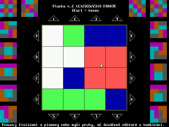

Potom můžeš vzít třeba ten Poznámkový blok a napsat v něm zdrojový kód toho programu. To je podle složitosti programu pár stovek, nebo také pár milionů řádků. Může vypadat třeba takhle:
Kód: Vybrat vše
REM placka22.bas - doplněná verze

start:
  DEFINT A-Z
  SCREEN 12, 0, 0
  COLOR 15
  fonttype = 0
  ON ERROR GOTO nejsouData
  OPEN "placka.dat" FOR INPUT AS #1
  ON ERROR GOTO vadnaData
    LINE (0, 0)-(639, 239), 1, BF
    LOCATE 2, 13: PRINT " Nahrávám data! "
  DIM text$(34)
    LOCATE 4, 6: PRINT " Texty: ";
    FOR i = 0 TO 33
      PRINT ".";
      INPUT #1, text$(i)
    NEXT i
  DIM font(223, 7, 2)
    LOCATE 6, 6: PRINT " Fonty: ";
    FOR f = 0 TO 1
      FOR r = 0 TO 223
        IF r MOD 8 = 0 THEN PRINT ".";
        FOR s = 0 TO 7
          INPUT #1, font(r, s, f)
    NEXT s, r, f
  DIM m(1 TO 35)
  DIM m$(1 TO 35, 1 TO 215)
    LOCATE 8, 6: PRINT " Hudba: ";
    FOR a = 1 TO 35
      PRINT ".";
      INPUT #1, m(a)
      FOR b = 1 TO m(a)
        INPUT #1, m$(a, b)
    NEXT b, a
  DIM asm AS STRING * 54
    LOCATE 10, 5: PRINT " Driver: ";
    FOR a = 1 TO 54
      PRINT ".";
      INPUT #1, a$
      MID$(asm, a) = CHR$(VAL("&H" + a$))
    NEXT a
  DIM kombr(14)
  DIM kombs(14)
  DIM komb(14, 3, 6)
    LOCATE 12, 2: PRINT " Kombinace: ";
    FOR a = 1 TO 14
      INPUT #1, kombr(a)
      INPUT #1, kombs(a)
      FOR b = 0 TO 3
        PRINT ".";
        FOR c = 0 TO 6 STEP 2
          INPUT #1, komb(a, b, c)
    NEXT c, b, a
  DIM testr(35, 4, 3)
  DIM tests(35, 4, 3)
    LOCATE 14, 5: PRINT " Vzorky: ";
    FOR a = 1 TO 35
      PRINT ".";
      FOR b = 1 TO 4
        FOR c = 0 TO 3
          INPUT #1, testr(a, b, c)
          INPUT #1, tests(a, b, c)
    NEXT c, b, a
  CLOSE #1
  ON ERROR GOTO chybaProgramu
  DEF fns (t) = 41 - (LEN(text$(t)) \ 2)
  GOSUB uvod
  RANDOMIZE TIMER
  GOSUB mouseInit
  DATA 5,5,5,5,5,6,6,5,3,6,5,8,5,6,5,5
  DATA 6,6,6,6,3,6,6,8,3,3,5,3,3,6,8,3
  DATA 3,8,3,8,3,8,5,3,8,6,8,8,3,8,8,8
cekani1:
  a$ = ""
  WHILE a$ = ""
    a$ = INKEY$
    IF a$ = "f" OR a$ = "F" THEN
      fonttype = 1 - fonttype
      GOSUB uvod
      a$ = ""
    END IF
    GOSUB mouseStatus
    IF mb = 1 THEN a$ = "b"
  WEND
  COLOR 15
  CLS
priprava:
  RESTORE priprava
  t = 25: radek = 2: sloupec = fns(t): GOSUB text
  t = 26: radek = 3: sloupec = fns(t): GOSUB text
  t = 27: radek = 30: sloupec = fns(t): GOSUB text
  DIM p(4, 4)
  DIM c(1 TO 4)
  t = 34
  FOR a = 1 TO 4
    text$(t) = CHR$(64 + a): radek = a * 5 + 4: sloupec = 18: GOSUB text
    text$(t) = CHR$(68 + a): radek = a * 5 + 4: sloupec = 63: GOSUB text
    text$(t) = MID$(STR$(a), 2, 1): radek = 5: sloupec = a * 10 + 16: GOSUB text
    text$(t) = MID$(STR$(a + 4), 2, 1): radek = 28: sloupec = a * 10 + 16: GOSUB text
    FOR b = 1 TO 4
losovani:
      c = INT(RND * 4) + 1
      IF c(c) = 4 THEN GOTO losovani
      p(a, b) = c
      c(c) = c(c) + 1
  NEXT b, a
melodie:
REM "Anděl"-6
REM "Batalion"-8
REM "Bedna od whisky"-5
REM "Bratříčku, zavírej vrátka"-5
REM "Dokud se zpívá"-6
REM "Ej, od Buchlova"-6
REM "Holubí dům"-7
REM "Hudsonské šífy"-7
REM "Chlupatý kaktus"-7
REM "Kdyby tady byla taková panenka"-4
REM "Když mě brali za vojáka"-5
REM "Kočka na okně"-6
REM "Krajina posedlá tmou"-6
REM "Motýl"-10
REM "Náhrobní kámen"-5
REM "Něco o lásce"-10
REM "Okno mé lásky"-5
REM "Po starých zámeckých schodech"-7
REM "Pramínek vlasů"-10
REM "Pravda a lež"-9
REM "Prídi ty, šuhajko"-8
REM "Purpura"-6
REM "Santa Lucia"-7
REM "Rikatado"-7
REM "Rosa na kolejích"-9
REM "Řeka hučí"-9
REM "Třešně zrály"-7
REM "Tři kríže"-8
REM "Už se ten Tálínskej rybník nahání"-5
REM "Veď mě dál, cesto má"-8
REM "Zelené pláně"-10
REM "Náš kraj"-7
REM "Dorogoj dlinnoju"-8
REM "Stěnka Razin"-8
REM "Million alych roz"-8
paleta:
  FOR a = 1 TO 4
    READ c(a)
  NEXT a
  DATA 1,12,10,15
sipky:
  FOR a = 1 TO 4
    LINE (a * 80 + 103, 78)-(a * 80 + 143, 78)
    LINE (a * 80 + 143, 78)-(a * 80 + 123, 58)
    LINE (a * 80 + 123, 58)-(a * 80 + 103, 78)
    LINE (a * 80 + 103, 431)-(a * 80 + 143, 431)
    LINE (a * 80 + 143, 431)-(a * 80 + 123, 451)
    LINE (a * 80 + 123, 451)-(a * 80 + 103, 431)
    LINE (146, a * 80 + 35)-(146, a * 80 + 75)
    LINE (146, a * 80 + 75)-(126, a * 80 + 55)
    LINE (126, a * 80 + 55)-(146, a * 80 + 35)
    LINE (492, a * 80 + 35)-(492, a * 80 + 75)
    LINE (492, a * 80 + 75)-(512, a * 80 + 55)
    LINE (512, a * 80 + 55)-(492, a * 80 + 35)
  NEXT a
kombinace:
  FOR a = 1 TO 14
    FOR b = 0 TO 3
        LOCATE kombr(a) + b, kombs(a) + c
        COLOR komb(a, b, c)
        PRINT "██";
  NEXT c, b, a
  COLOR 15
  LINE (158, 94)-(480, 416), 14, B
  GOSUB mouseShow
  GOSUB maluj
klavesa:
  a$ = INKEY$
  GOSUB mouseStatus
  IF a$ = "" THEN GOTO klavesa
posun:
  IF a$ < "a" OR a$ > "h" THEN
    IF a$ < "1" OR a$ > "8" THEN
      IF a$ = CHR$(27) THEN
        GOTO konec
      ELSE
        GOTO klavesa
      END IF
    ELSE
      IF a$ > "4" THEN
        a = VAL(a$) - 4
        p(0, a) = p(4, a)
        FOR b = 4 TO 1 STEP -1
          p(b, a) = p(b - 1, a)
        NEXT b
      ELSE
        a = VAL(a$)
        FOR b = 0 TO 3
          p(b, a) = p(b + 1, a)
        NEXT b
        p(4, a) = p(0, a)
      END IF
    END IF
  ELSE
    IF a$ > "d" THEN
      a = ASC(a$) - 100
      p(a, 0) = p(a, 4)
        p(a, b) = p(a, b - 1)
      NEXT b
    ELSE
      a = ASC(a$) - 96
      FOR b = 0 TO 3
        p(a, b) = p(a, b + 1)
      NEXT b
      p(a, 4) = p(a, 0)
    END IF
  END IF
test:
  PLAY "t255o3l64cde"
  GOSUB maluj
  FOR a = 1 TO 35
    f = 1
    FOR b = 1 TO 4
      FOR c = 1 TO 3
        IF p(testr(a, b, c - 1), tests(a, b, c - 1)) <> p(testr(a, b, c), tests(a, b, c)) THEN f = 0
    NEXT c, b
    IF f THEN GOTO hudba
  NEXT a
delay:
  a$ = INKEY$
  GOSUB mouseStatus
  IF LEN(a$) THEN GOTO delay
GOTO klavesa
konec:
  LINE (160, 16)-(471, 47), 0, BF
  t = 28: radek = 2: sloupec = fns(t): GOSUB text
  t = 29: radek = 3: sloupec = fns(t): GOSUB text
  PLAY "t255o4l2c"
cekani2:
  a$ = INPUT$(1)
  IF a$ = "a" OR a$ = "A" OR a$ = CHR$(13) THEN GOTO ven
  IF a$ = "n" OR a$ = "N" OR a$ = CHR$(27) THEN
    GOTO klavesa
  END IF
GOTO cekani2
ven:
  CLS
  t = 30: radek = 12: sloupec = fns(t): GOSUB text
  t = 31: radek = 13: sloupec = fns(t): GOSUB text
  t = 32: radek = 14: sloupec = fns(t): GOSUB text
  t = 33: radek = 15: sloupec = fns(t): GOSUB text
  t = 30: radek = 16: sloupec = fns(t): GOSUB text
  SLEEP 3
  SCREEN 0, 0, 0
SYSTEM
maluj:
  GOSUB mouseHide
  FOR a = 1 TO 4
    FOR b = 1 TO 4
      LINE (b * 80 + 80, a * 80 + 16)-(b * 80 + 158, a * 80 + 94), c(p(a, b)), BF
  NEXT b, a
  GOTO mouseShow
RETURN
hudba:
  f = 1
  GOSUB mouseHide
  FOR b = 1 TO m(a)
    IF LEN(INKEY$) THEN f = 0
    IF f THEN PLAY m$(a, b)
  NEXT b
  GOSUB mouseShow
GOTO delay
mouseInit:
  ax = 0
  GOSUB driver
RETURN
mouseShow:
  ax = 1
  GOSUB driver
RETURN
mouseHide:
  ax = 2
  GOSUB driver
RETURN
mouseStatus:
  ax = 3
  GOSUB driver
  IF mb = 1 THEN
    IF mx < 120 OR mx > 518 OR my < 56 OR my > 454 THEN RETURN
    mx = mx - 80
    my = my - 16
    r = my \ 80
    s = mx \ 80
    IF r = 0 OR r = 5 THEN
      IF s > 0 AND s < 5 THEN
        a = s
        IF r = 5 THEN a = a + 4
        a$ = RIGHT$(STR$(a), 1)
      END IF
    END IF
    IF s = 0 OR s = 5 THEN
      IF r > 0 AND r < 5 THEN
        a = r
        IF s = 5 THEN a = a + 4
        a$ = RIGHT$(CHR$(a + 96), 1)
      END IF
    END IF
  END IF
RETURN
driver:
  DEF SEG = VARSEG(asm)
  CALL Absolute(ax, mb, mx, my, VARPTR(asm))
RETURN
uvod:
  COLOR 15
  CLS
  LINE (0, 0)-(639, 479), , B
  LINE (1, 1)-(638, 478), , B
  LINE (3, 3)-(636, 476), , B
  RESTORE
  FOR a = 4 TO 28
    t = a - 4: radek = a: sloupec = 41 - LEN(text$(a - 4)) \ 2: GOSUB text
  NEXT a
  FOR a = 12 TO 15
    FOR b = 37 TO 43 STEP 2
      READ c
      LOCATE a, b - 12
      COLOR c
      PRINT "██"
      READ c
      LOCATE a, b
      COLOR c
      PRINT "██"
      READ c
      LOCATE a, b + 12
      COLOR c
      PRINT "██"
  NEXT b, a
RETURN
text:
  FOR i = 1 TO LEN(text$(t))
    znak = ASC(MID$(text$(t), i, 1))
    FOR j = 0 TO 7
      LINE (sloupec * 8 - 8 + j, radek * 16 - 16)-(sloupec * 8 - 8 + j, radek * 16 - 1), , , font(znak - 32, j, fonttype)
    NEXT j
    sloupec = sloupec + 1
    IF sloupec > 80 THEN sloupec = 1: radek = radek + 1
    IF radek > 30 THEN radek = 1
  NEXT i
RETURN

Ten pak pomocí kompilátoru toho jazyka přeložíš do spustitelného kódu, kterému rozumí procesor počítače.
Také je potřeba nashromáždit data, která ten program bude zpracovávat, obrázky, videa, zvuky... Ta mívají u špičkových her třeba tisíckrát větší objem než samotný kód programu.
Kód: Vybrat vše
"Návod k logické hře Placka:","─────────────────────────────",""
"Placka je (o hodně) jednodušší varianta Rubikovy kostky."
"Pomocí kláves nebo myši se posouvají sloupce a řádky tak,"
"aby čtverce vytvořily určitou barevnou kombinaci."
"Základní kombinace jsou čtverce a pruhy:","","","","","",""
"Další kombinace jsou zobrazeny po stranách hrací plochy."
"Některé z nich mají víc možností - tak jako pruhy mohou být"
"převrácené do dvou, nebo do čtyř poloh. Celkem zná program"
"35 kombinací, složení každé z nich odmění zahráním melodie."
"Tu lze přerušit stiskem klávesy. Barvy ve vzorech se nemusí"
"shodovat se skutečností, program rozlišuje jen jejich"
"rozmístění. Hru lze ukončit klávesou Escape, program si"
"vyžádá potvrzení Ano nebo Ne.","","Pěknou zábavu přeje FARAON.",""
"(F - výběr fontu, pro vstup do hry stiskni jinou klávesu nebo myš)"
"Placka v.2 (C)2003/2010 FARAON","[Esc] = konec"

A výsledek může vypadat třeba takhle:
Screenshot hry Placka.png (3.64 KiB) Zobrazeno 1231 x
