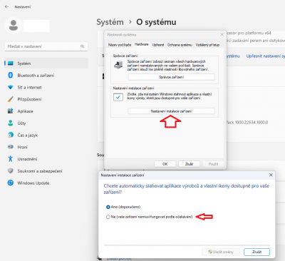

Driver Management has concluded the process to add Service IntcAzAudAddService for Device Instance ID HDAUDIO\FUNC_01&VEN_10EC&DEV_0257&SUBSYS_17AA5125&REV_1000\5&28CBF551&0&0001 with the following status: 0.
toto vypisuje v detailoch ovladaca, ono tam najprv bolo Realtek High Definition Audio, no ale potom sa to zmenilo na Realtek(R) Audio, zaklikla som to, aby to neupdatovalo automaticky a zvolila "Nie" v prilohe vyssie.

Ale ako je mozne, ze ja nainstalujem realtek driver z lenovo stranky, ktory je najnovsi na tento laptop a neponuka v program files zlozku Realtek HDA, kde mozem najst tento RtkNGUI64.exe ? Ako to je mozne? Ze mi ovladac 2017 ponuka tuto zlozku, je to tam, ale ked to nainstalujem od vyrobcu, tak ta zlozka tam nie je.
