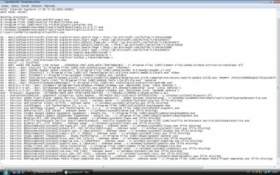

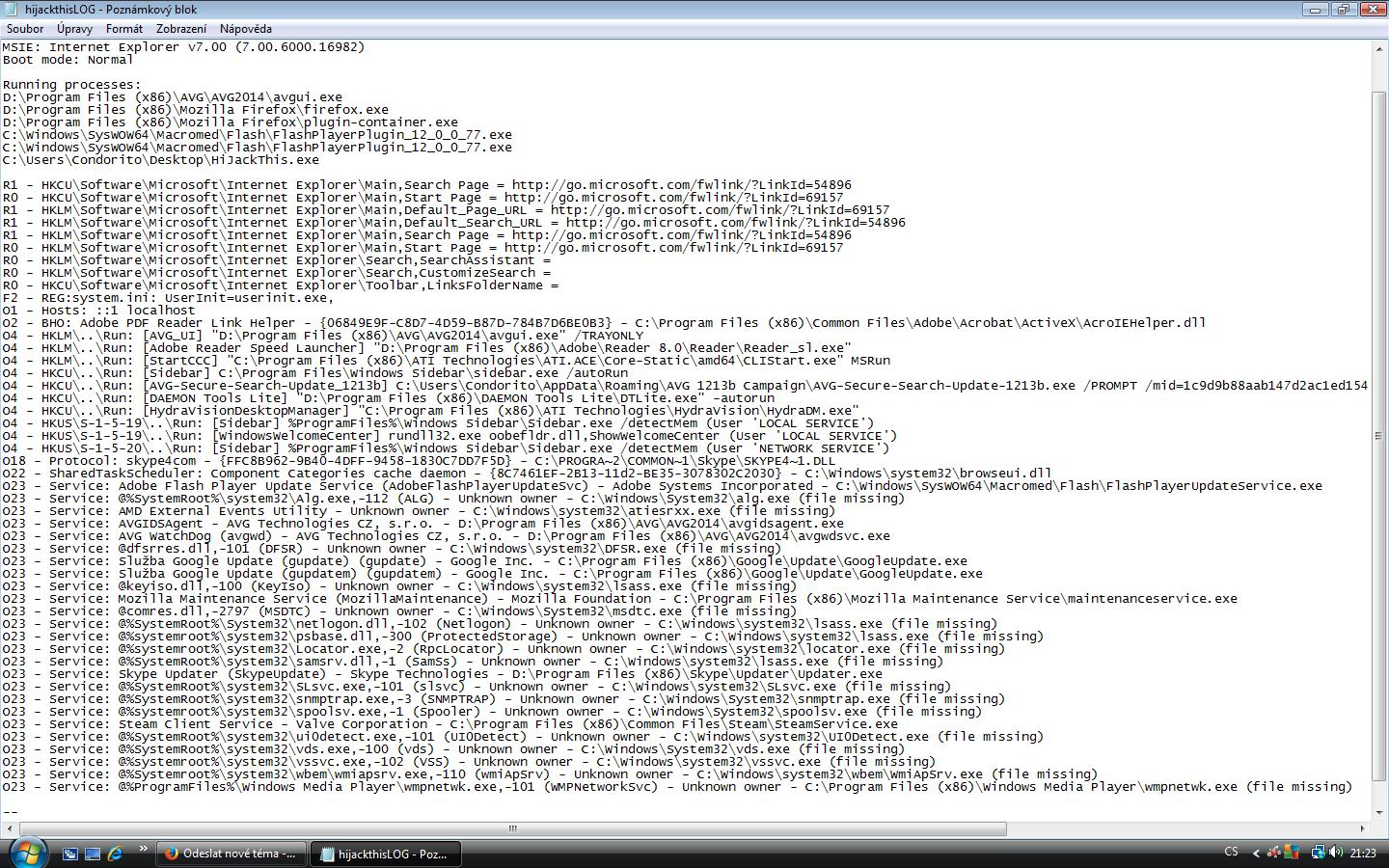

Log z hjt zde a jdu se vrhnout na to co popsal JARO3..
Scan saved at 22:32:25, on 3.4.2014
Platform: Windows Vista (WinNT 6.00.1904)
MSIE: Internet Explorer v7.00 (7.00.6000.16982)
Boot mode: Normal
Running processes:
C:\Program Files (x86)\ATI Technologies\HydraVision\HydraDM.exe
D:\Program Files (x86)\AVG\AVG2014\avgui.exe
D:\Program Files (x86)\Mozilla Firefox\firefox.exe
D:\Program Files (x86)\Mozilla Firefox\plugin-container.exe
C:\Windows\SysWOW64\Macromed\Flash\FlashPlayerPlugin_12_0_0_77.exe
C:\Users\Condorito\Desktop\HiJackThis.exe
R0 - HKCU\Software\Microsoft\Internet Explorer\Main,Start Page = http://go.microsoft.com/fwlink/?LinkId=69157
F2 - REG:system.ini: UserInit=userinit.exe,
O1 - Hosts: ::1 localhost
O2 - BHO: Adobe PDF Reader Link Helper - {06849E9F-C8D7-4D59-B87D-784B7D6BE0B3} - C:\Program Files (x86)\Common Files\Adobe\Acrobat\ActiveX\AcroIEHelper.dll
O4 - HKLM\..\Run: [AVG_UI] "D:\Program Files (x86)\AVG\AVG2014\avgui.exe" /TRAYONLY
O4 - HKLM\..\Run: [Adobe Reader Speed Launcher] "D:\Program Files (x86)\Adobe\Reader 8.0\Reader\Reader_sl.exe"
O4 - HKLM\..\Run: [StartCCC] "C:\Program Files (x86)\ATI Technologies\ATI.ACE\Core-Static\amd64\CLIStart.exe" MSRun
O4 - HKCU\..\Run: [Sidebar] C:\Program Files\Windows Sidebar\sidebar.exe /autoRun
O4 - HKCU\..\Run: [AVG-Secure-Search-Update_1213b] C:\Users\Condorito\AppData\Roaming\AVG 1213b Campaign\AVG-Secure-Search-Update-1213b.exe /PROMPT /mid=1c9d9b88aab147d2ac1ed1543be1e502-a01e9e89512bd70c0f6236020492ffec464d3735 /CMPID=1213b
O4 - HKCU\..\Run: [DAEMON Tools Lite] "D:\Program Files (x86)\DAEMON Tools Lite\DTLite.exe" -autorun
O4 - HKCU\..\Run: [HydraVisionDesktopManager] "C:\Program Files (x86)\ATI Technologies\HydraVision\HydraDM.exe"
O4 - HKUS\S-1-5-19\..\Run: [Sidebar] %ProgramFiles%\Windows Sidebar\Sidebar.exe /detectMem (User 'LOCAL SERVICE')
O4 - HKUS\S-1-5-19\..\Run: [WindowsWelcomeCenter] rundll32.exe oobefldr.dll,ShowWelcomeCenter (User 'LOCAL SERVICE')
O4 - HKUS\S-1-5-20\..\Run: [Sidebar] %ProgramFiles%\Windows Sidebar\Sidebar.exe /detectMem (User 'NETWORK SERVICE')
O18 - Protocol: skype4com - {FFC8B962-9B40-4DFF-9458-1830C7DD7F5D} - C:\PROGRA~2\COMMON~1\Skype\SKYPE4~1.DLL
O22 - SharedTaskScheduler: Component Categories cache daemon - {8C7461EF-2B13-11d2-BE35-3078302C2030} - C:\Windows\system32\browseui.dll
O23 - Service: Adobe Flash Player Update Service (AdobeFlashPlayerUpdateSvc) - Adobe Systems Incorporated - C:\Windows\SysWOW64\Macromed\Flash\FlashPlayerUpdateService.exe
O23 - Service: AMD External Events Utility - Unknown owner - C:\Windows\system32\atiesrxx.exe (file missing)
O23 - Service: AVGIDSAgent - AVG Technologies CZ, s.r.o. - D:\Program Files (x86)\AVG\AVG2014\avgidsagent.exe
O23 - Service: AVG WatchDog (avgwd) - AVG Technologies CZ, s.r.o. - D:\Program Files (x86)\AVG\AVG2014\avgwdsvc.exe
O23 - Service: @dfsrres.dll,-101 (DFSR) - Unknown owner - C:\Windows\system32\DFSR.exe (file missing)
O23 - Service: Služba Google Update (gupdatem) (gupdatem) - Google Inc. - C:\Program Files (x86)\Google\Update\GoogleUpdate.exe
O23 - Service: Skype Updater (SkypeUpdate) - Skype Technologies - D:\Program Files (x86)\Skype\Updater\Updater.exe
O23 - Service: @%SystemRoot%\system32\SLsvc.exe,-101 (slsvc) - Unknown owner - C:\Windows\system32\SLsvc.exe (file missing)
O23 - Service: @%ProgramFiles%\Windows Media Player\wmpnetwk.exe,-101 (WMPNetworkSvc) - Unknown owner - C:\Program Files (x86)\Windows Media Player\wmpnetwk.exe (file missing)
End of file - 6278 bytes

Mimochodem aktualizace Vist mi nenabizi sp2 nybrz pouze sp1 aktualizaci takze ani nevim kde jinde se po tom mam podivat :/
RogueKiller V8.8.15 _x64_ [Mar 27 2014] by Adlice Software
Podpora : http://forum.adlice.com
Webové stránky : http://www.adlice.com/softwares/roguekiller/
Operační systém : Windows Vista (6.0.6000 ) 64 bits version
Spuštěno v : Normální režim
Uživatel : Condorito [Práva správce]
Mód : Kontrola -- Datum : 04/07/2014 15:40:49
| ARK || FAK || MBR |
¤¤¤ Škodlivé procesy: : 0 ¤¤¤
¤¤¤ ¤¤¤ Záznamy Registrů: : 6 ¤¤¤
[RUN][SUSP PATH] HKCU\[...]\Run : AVG-Secure-Search-Update_1213b (C:\Users\Condorito\AppData\Roaming\AVG 1213b Campaign\AVG-Secure-Search-Update-1213b.exe /PROMPT /mid=1c9d9b88aab147d2ac1ed1543be1e502-a01e9e89512bd70c0f6236020492ffec464d3735 /CMPID=1213b [x][x]) -> NALEZENO
[RUN][SUSP PATH] HKUS\S-1-5-21-1410354977-1552960266-3762102102-1000\[...]\Run : AVG-Secure-Search-Update_1213b (C:\Users\Condorito\AppData\Roaming\AVG 1213b Campaign\AVG-Secure-Search-Update-1213b.exe /PROMPT /mid=1c9d9b88aab147d2ac1ed1543be1e502-a01e9e89512bd70c0f6236020492ffec464d3735 /CMPID=1213b [x][x]) -> NALEZENO
[HJ POL][PUM] HKCU\[...]\System : DisableTaskMgr (0) -> NALEZENO
[HJ POL][PUM] HKCU\[...]\System : DisableRegistryTools (0) -> NALEZENO
[HJ DESK][PUM] HKLM\[...]\NewStartPanel : {59031a47-3f72-44a7-89c5-5595fe6b30ee} (1) -> NALEZENO
[HJ DESK][PUM] HKLM\[...]\NewStartPanel : {20D04FE0-3AEA-1069-A2D8-08002B30309D} (1) -> NALEZENO
¤¤¤ naplánované úlohy : 1 ¤¤¤
[V2][SUSP PATH] AVG_SYS_TASK : C:\ProgramData\AVG 0214c Campaign\AVG-Secure-Search-Update-0214c.exe - --TASK_START_SYS --CMPID=0214c [x] -> NALEZENO
¤¤¤ spuštění položky : 0 ¤¤¤
¤¤¤ Webové prohlížeče : 0 ¤¤¤
¤¤¤ Browser Addons : 0 ¤¤¤
